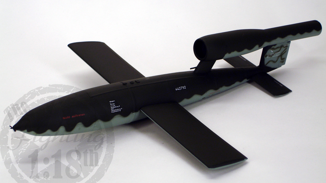

Although the real life V-1 is simple in design, the 1:1 version does have rivets along it’s panel lines and I would have liked to have seen more of those if this piece had come from one of the larger companies. Even with that concession, I still have to wonder how much more difficult or expensive to add a few more simple details like this.

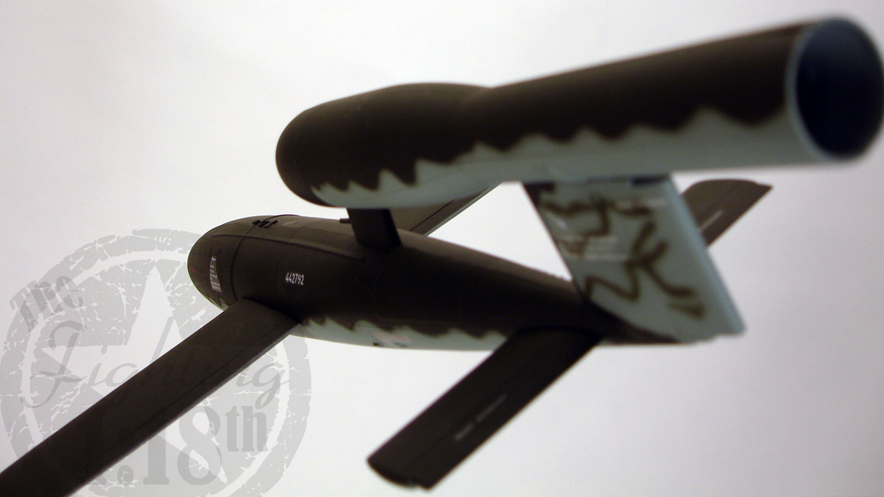

There are some nice touches to the craft, most noticeably the small timing propeller on the nose. The propeller does actually spin and is a great detail that may have been left out in a rush. The nose where the propeller sits begins to come to a point, like the real version, but looks cut short. This doesn’t detract from the toy at all, but it did make me look closer when i saw how the real version looked.
The engine’s intake also has a nice crosshatch type pattern molded into it and the fuselage is also covered in authentic German markings to complete the crafts small details. Despite these things there is nothing on the aircraft that made me say “Wow” as I opened the box.
The bottom is almost devoid of any details at all, save for a few panel lines and what might be the “clamp” for the loading ramp. If that is, in fact, what it is, the clamp or fastener, whatever, is just a rectangular… thing.

If you examine wartime-vintage photos of the real vehicle, you’ll note that the shape of the model is off in several key aspects. (You have to be careful of post-war photos and current airframes, however, as V-1s were assembled incorrectly, with missing or surrogate parts in place of the warhead or other sections.)
o The contour of the nose is quite a bit off. On the original, the taper from the propeller aft through the compass area and into the warhead was very smoothly blended; the contours of the first 3/4″ of the model nose really do not look anything like the real article.

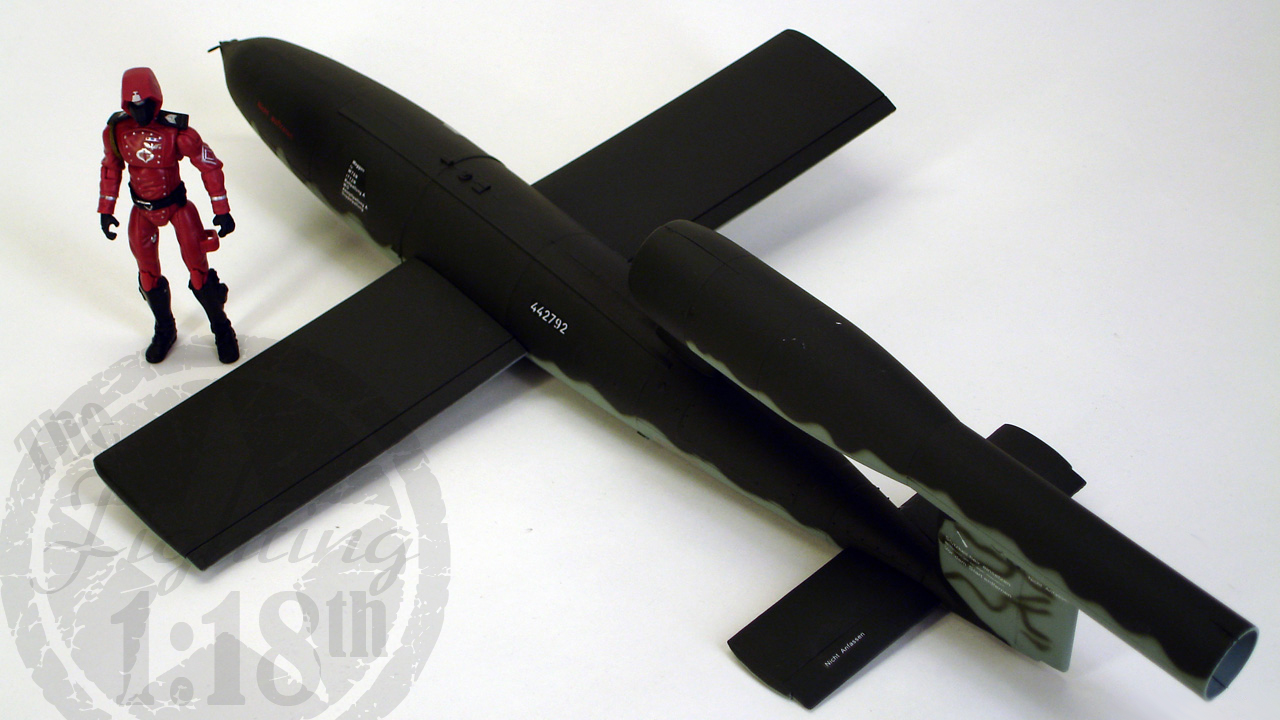

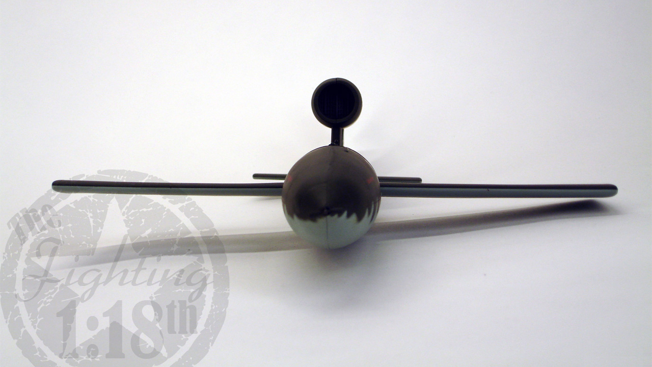

o The fuel tank section on the real V-1 was constant diameter, per the dimensions in Dieter Holsken’s book, “V-Missiles of the Third Reich” and corroborating photographs. On the Pegasus model, there is no constant diameter “tube” and the fuselage begins to taper near the middle of the wing, such that the diameter of the fuel section is noticeably smaller at the aft end than at the front.
o This premature taper affects the shape of the aft fuselage significantly, causing it to be too slender all the way to the aft-most point. As a result, the front engine support pylon and vertical tail/rudder appear too tall.
o The engine itself has an incorrect taper between the thicker, combustion chamber section and the tailpipe. It should be essentially a linear cone, but on the model it has some longitudinal curvature.
o The 1:1 vehicle was built very simply, in cyclindrical sections that bolted together end-to-end. There were a few rivets around access panels but, in general, the skins were rolled into shape and butt-welded together. As a result, the longitudinal seams should have been convex and weld-like rather than cleanly scribed into the moldline as on the model.
o The details generally leave something to be desired. The rectangular blob on the bottom mentioned in the article should have been a slot for the launch shuttle. The real vehicle had an external dorsal lanyard that ran from the compass at the front to the guidance and steering section at the rear. On the model, the raised ridge representing the lanyard starts aft of the warhead, instead of at the aft end of the compass housing.
o Something not specifically mentioned in the article but evident in the photos is the low quality of the applied markings. For the most part, the larger model manufacturers have used a pad-printing process to apply detailed markings such as stenciling. By using what appear to be waterslide decals for markings, the Pegasus model has shiny patches around the stenciled letters. I found this to be very distracting. A clear dull-coat spray might fix this, if that is the only thing that really bothers you.
Overall, these characteristics make the model appear very toy-like. I don’t think Pegasus Hobbies did much research when preparing this model. In fact, for most intents and purposes, the Pegasus model looks like a scaled-up version of the 1/48th scale Tamiya kit, the inaccuracies of which have been commented on rather extensively in modeling forums.
I’d say Paul’s assessment of an overall C is pretty much on the mark; I might even suggest a C- when compared to the average of what else is out there in this scale. The most comparable model of other 1:18 scale offerings would be the first-generation 21st Century P-51. I’d really hoped when I saw this model being released that it would be of comparable quality to the other large-scale models at the time, which had advanced significantly. At ~$30, it’s a nice enough “toy” to have, but with its flaws it doesn’t even represent something that could be readily customized into a true scale model of the unmanned Fi-103, or the manned Fi-103R. You might be better off scratch-building something, if that’s your goal.
