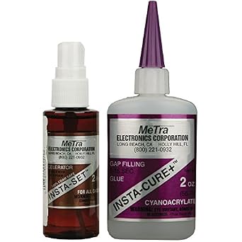

Hey hey! That's cool. But yeah, like NSA I've yet to see that truck.
If you get some of this glue and insta-set you wouldn't need the clamps. The project would move along a LOT quicker.

Those were not sold in the States. I got mine from Peterkin Toys in England. I traded some 1/6 scale pieces for the shipping costs to a friend of mine there. They are sold on eBay, but are pretty pricy. GI*EDDIE I stay away from cyanoacrylate glues unless I am gluing metal or dissimilar materials (wood to plastic, metal to wood etc.). MEK (testors liquid, various plastic model glues) for polystyrene or one of a number of decent ABS plastic glues creates a chemical weld in plastics. Makes for a stronger bond that does not degrade as quickly over time as cyanoacrylate glues. That has been my experience anyway. While I have just gotten into customizing 3.75 in or 1/18 scale military vehicles I have been a 1/35th scale armor and sci-fi modeler for 32 years.
